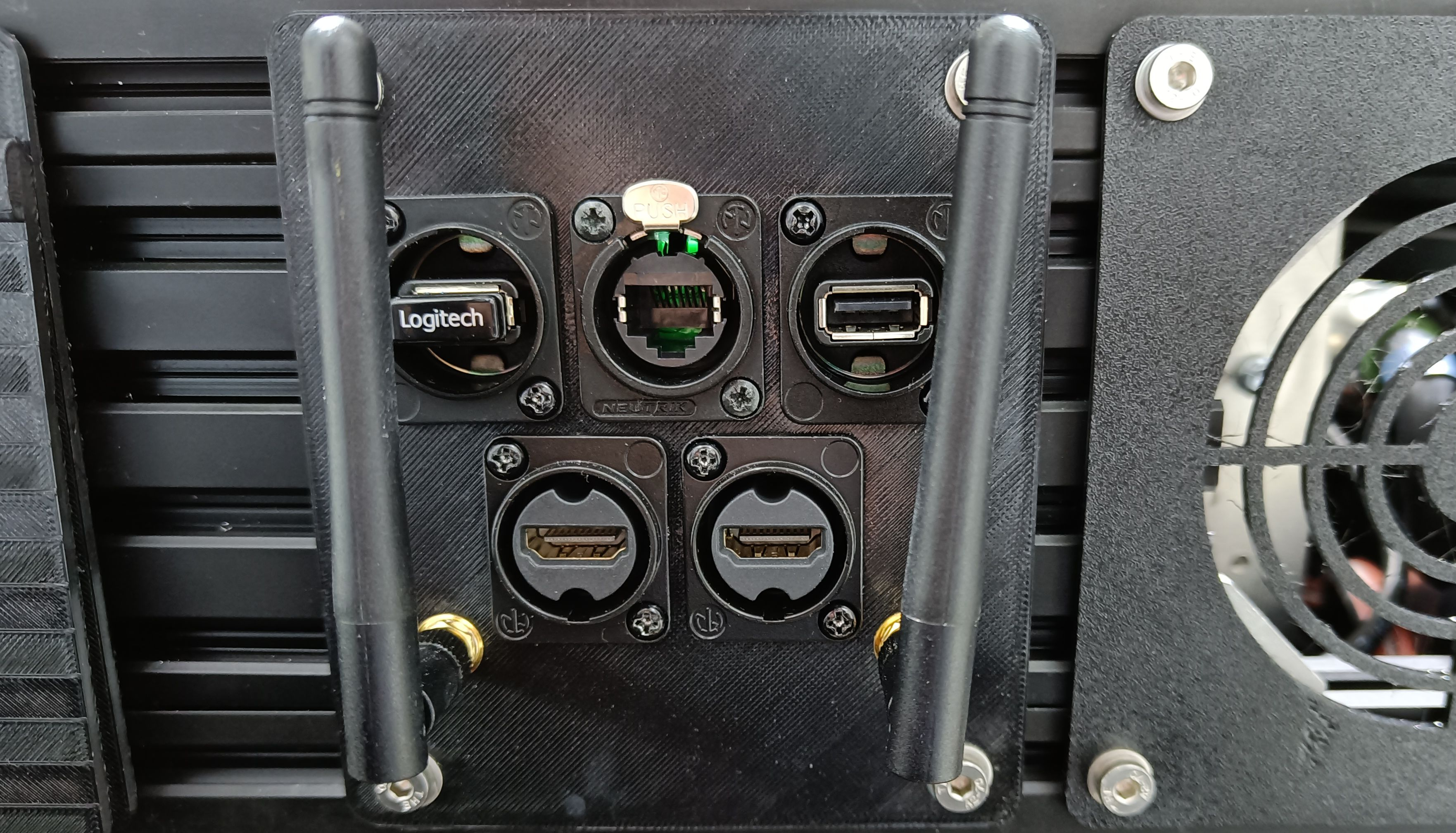

The Ethernet port at the back of the Husky can be utilized for setting up communication via LAN.
