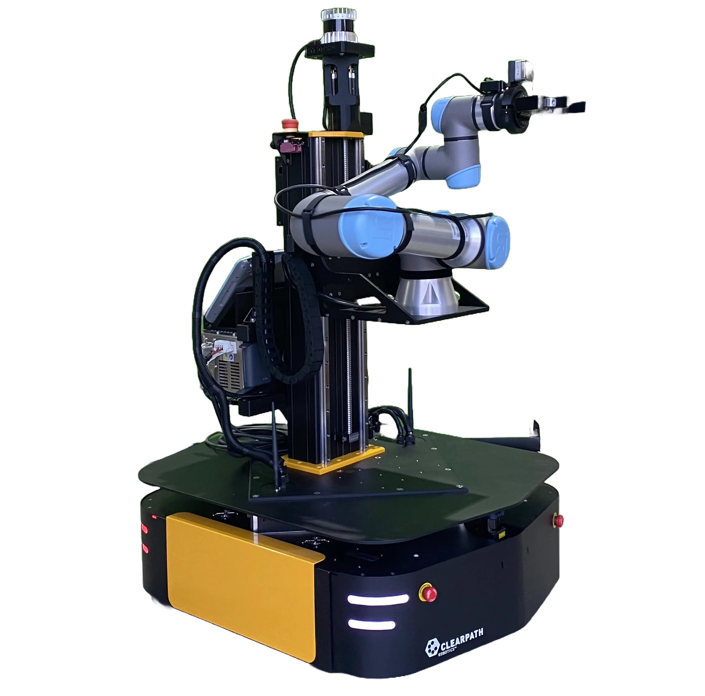

_images/mmp_r100.png
MMP DAR

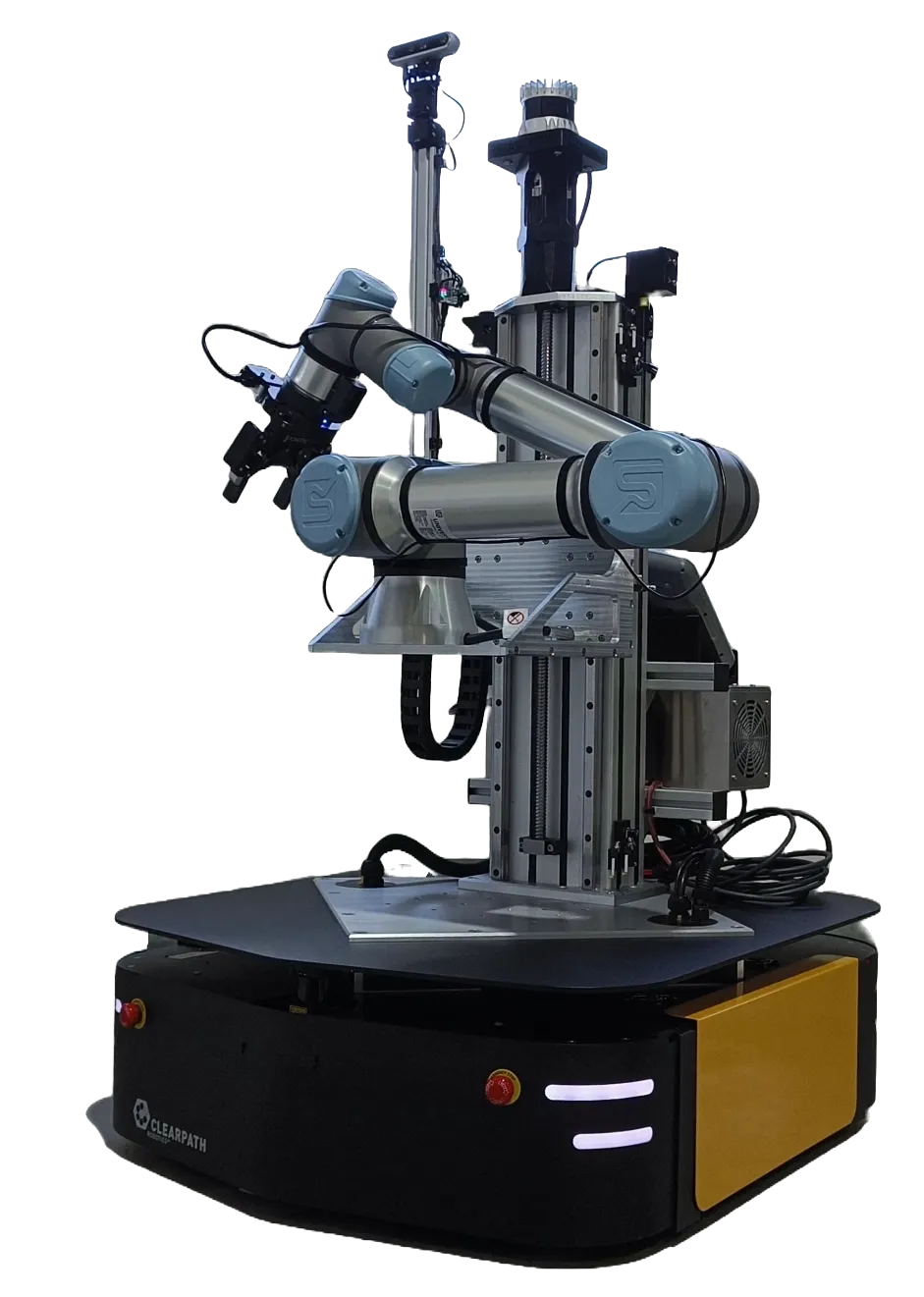

_images/mmp_ur5e.webp
MMP DRE

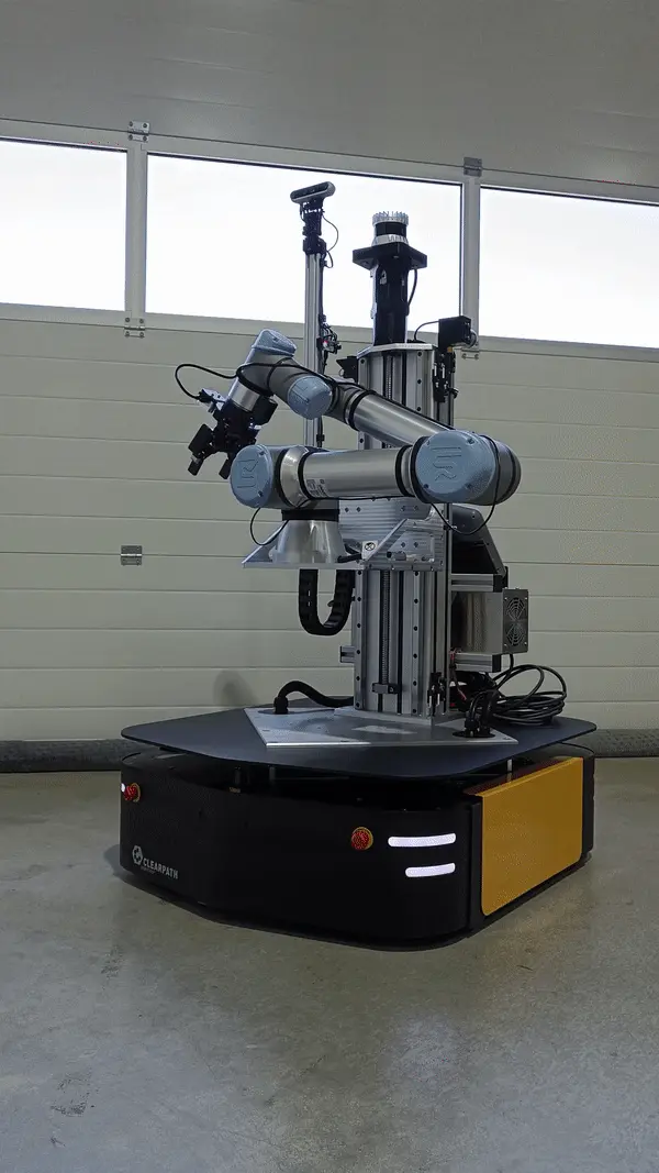

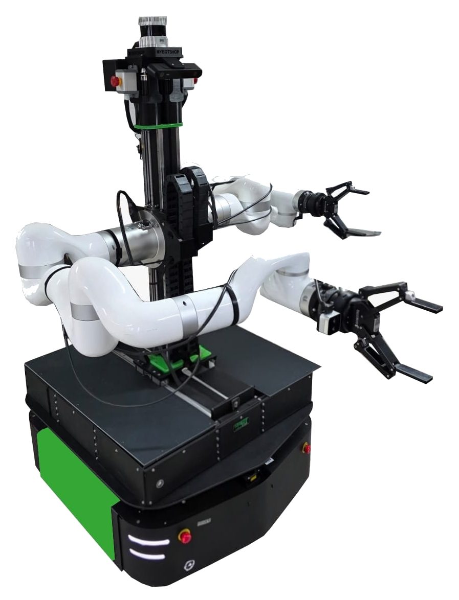

_images/mmp_ru_front.webp
The Mobile Manipulation Platform (MMP) Ridgeback in action, demonstrating mobility and dual-arm coordination.

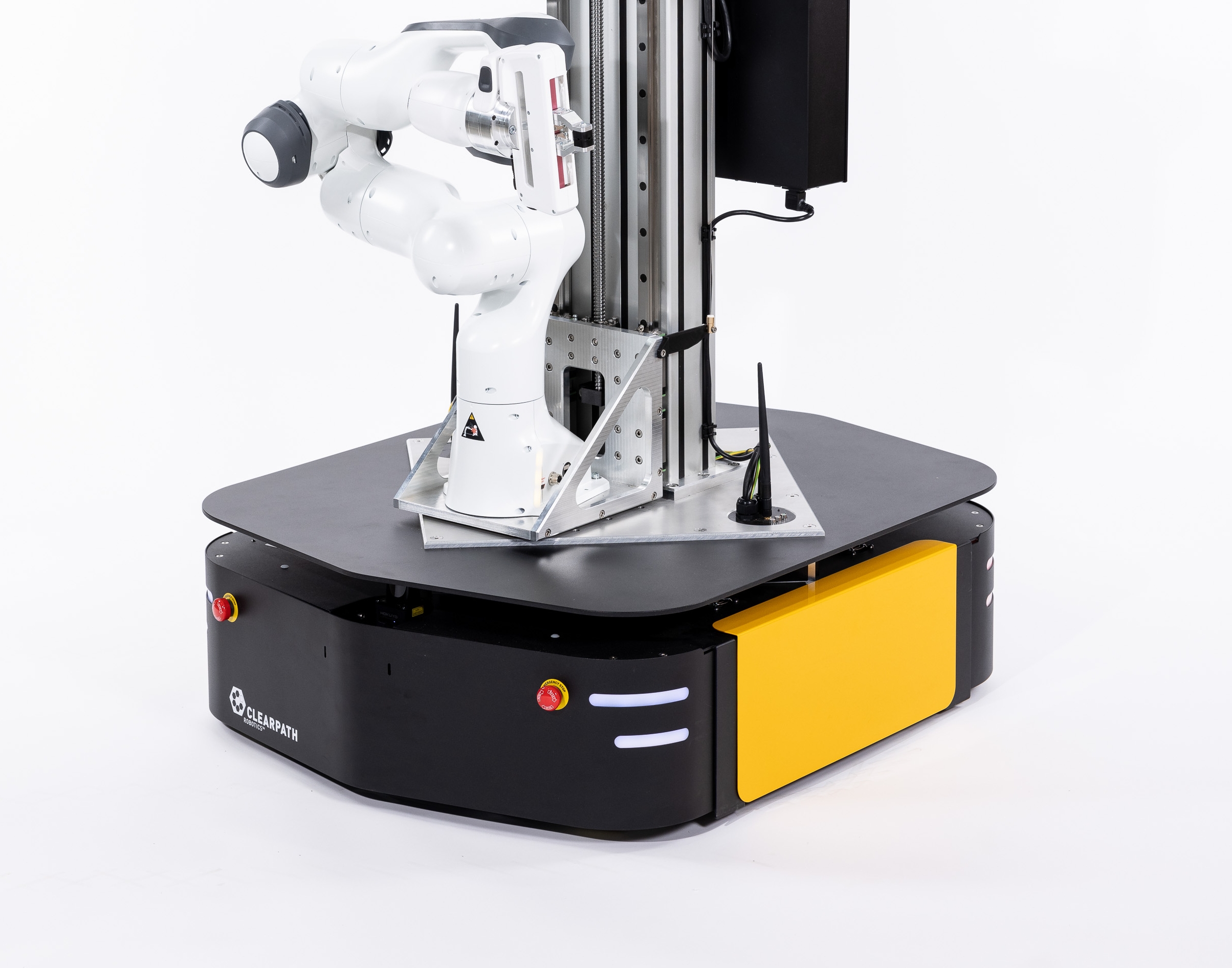

Clearpath Ridgeback
The Clearpath Ridgeback is a highly adaptable, mid-sized robotic platform, engineered to meet the demanding requirements of both research and development as well as industrial environments. Its low-profile design makes it ideal for navigating tight spaces, while its robust build ensures stability and durability. The Ridgeback’s versatility stems from its advanced features and extensive customization options, making it a go-to solution for a wide array of applications.
Key Features:
  • Omni-Directional Movement: The Ridgeback is equipped with advanced omni-directional wheels, allowing it to move seamlessly in any direction. This capability provides unparalleled maneuverability, making it perfect for dynamic and cluttered environments.
  • Precise Control: With its high-precision control systems, the Ridgeback can execute complex movements and tasks with exceptional accuracy. This precision is crucial for applications requiring delicate handling and exact positioning.
  • 360-Degree Field of View: The platform features a comprehensive 360-degree field of view, ensuring that it can perceive and navigate its surroundings effectively. This all-encompassing vision is essential for obstacle avoidance and environment mapping.
Customization and Components:
The Ridgeback’s current configuration is tailored to enhance its functionality and adaptability, featuring the following components:

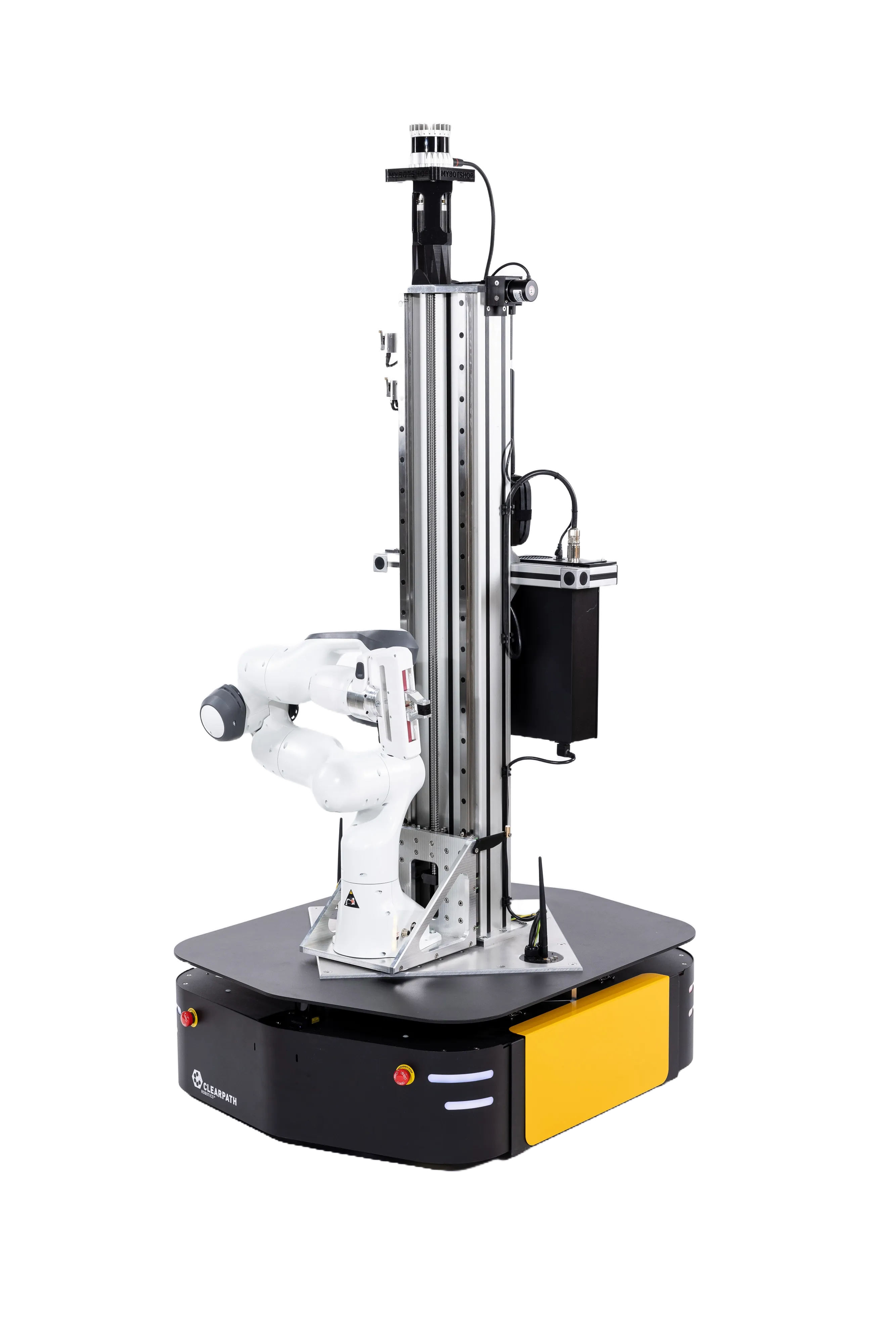

  1. Movable Lift with Robotic Arm:
    A customizable, movable lift system is integrated into the Ridgeback, providing variable height adjustment to the attached robotic arm. This setup allows for a wide range of manipulation tasks, from picking and placing to complex assembly operations.

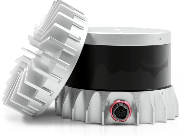

  2. Ouster 3D Scanner:
    Mounted on top of the lift, the Ouster 3D scanner delivers a 360-degree, high-resolution scan of the environment. This sensor is vital for creating detailed 3D maps, detecting obstacles, and navigating complex spaces with precision.

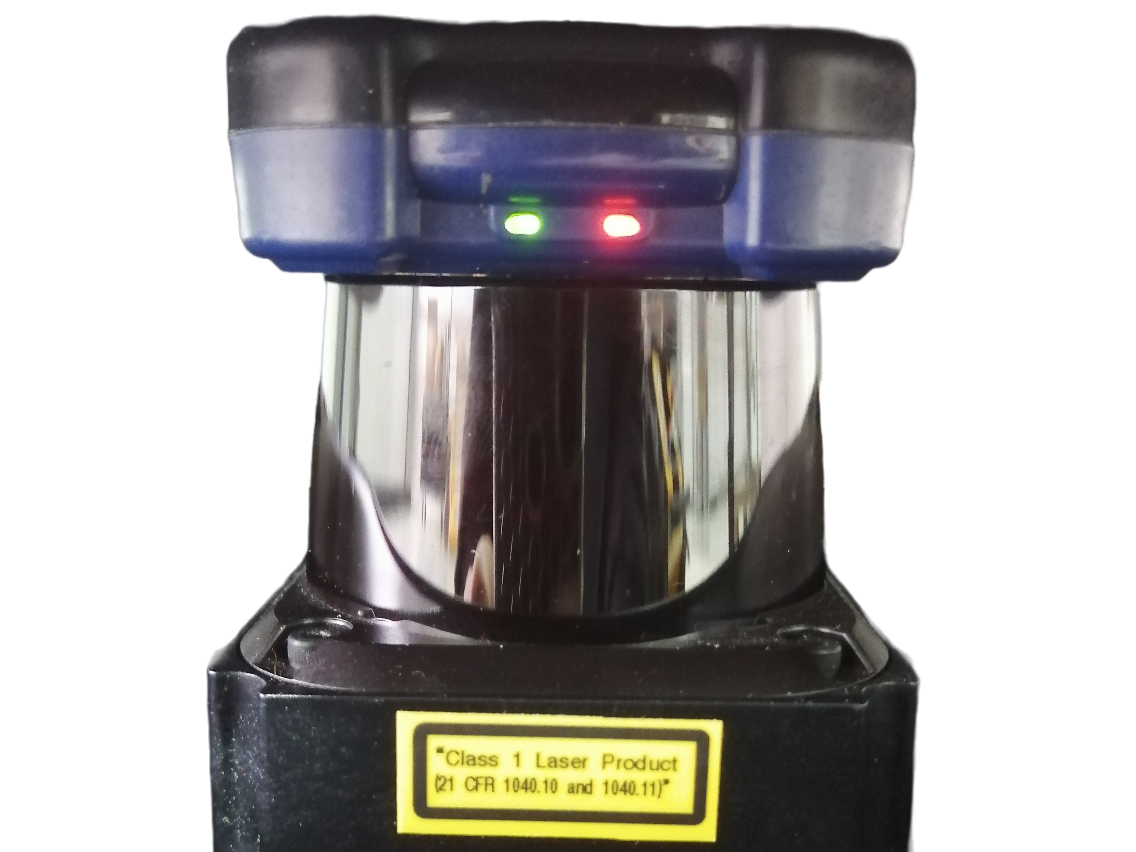

  3. Hokuyo Lidar Sensors:
    The Ridgeback is equipped with two Hokuyo lidar sensors, one positioned at the front and the other at the back. Each sensor provides a 360-degree coverage, offering comprehensive environmental sensing. This dual lidar setup enhances the robot’s ability to detect obstacles, ensuring safe and efficient operation.

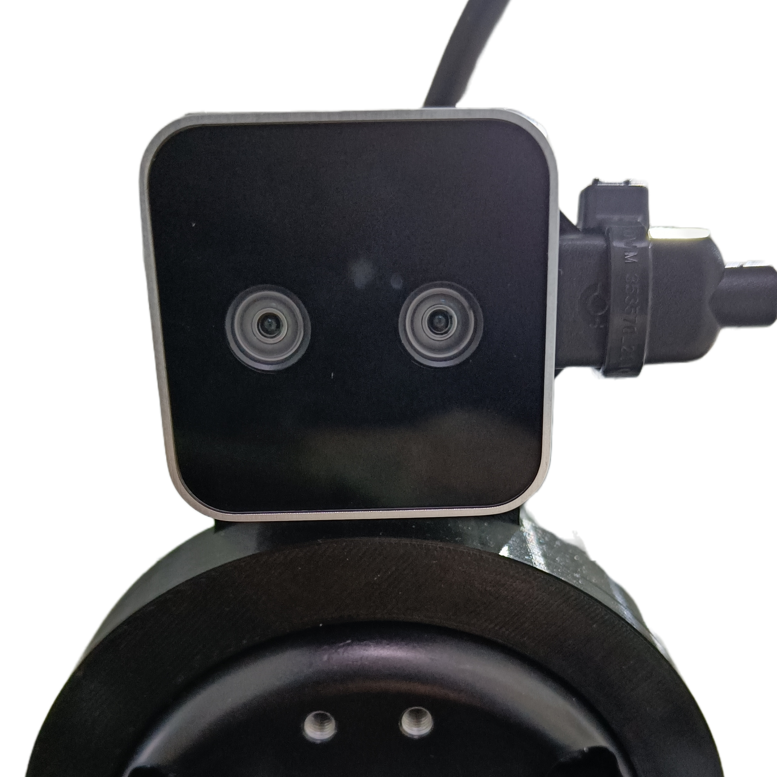

  4. Intel RealSense D455 and D405:
The Ridgeback is outfitted with Intel RealSense D455 and D405 cameras, delivering advanced depth sensing capabilities. The D455 offers a longer range and higher accuracy for wide-area scanning, while the D405 provides precise short-range depth data. This combination enables robust 3D perception for various applications, from navigation to object recognition.

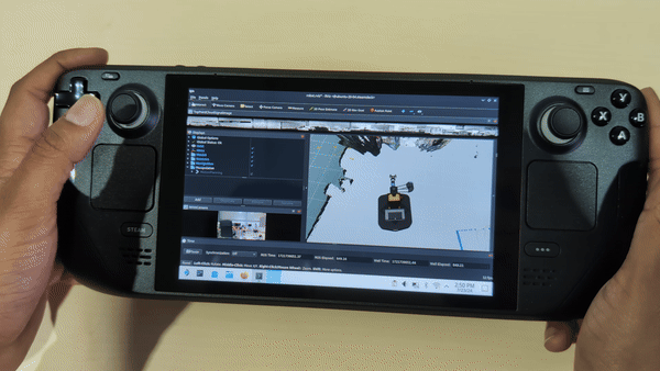

  1. Control Joystick — Steamdeck Controller:
For intuitive manual control, the Ridgeback includes a Steamdeck controller. This versatile joystick allows operators to effortlessly maneuver the robot and manage its functions, offering a user-friendly interface for real-time adjustments and remote operation.

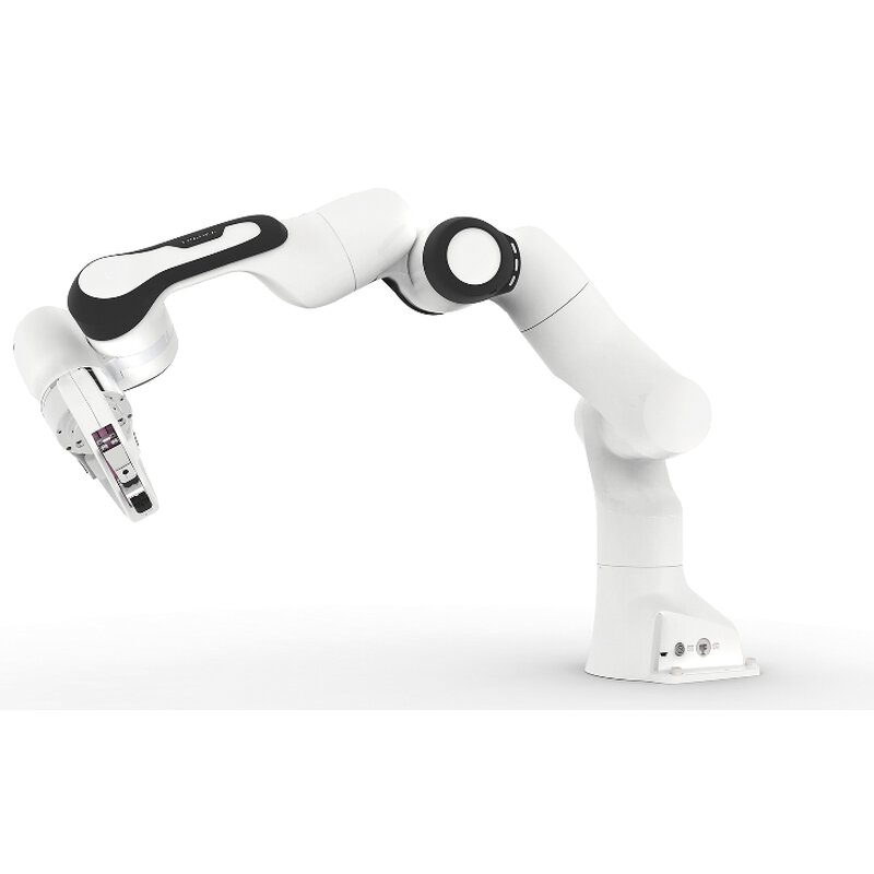

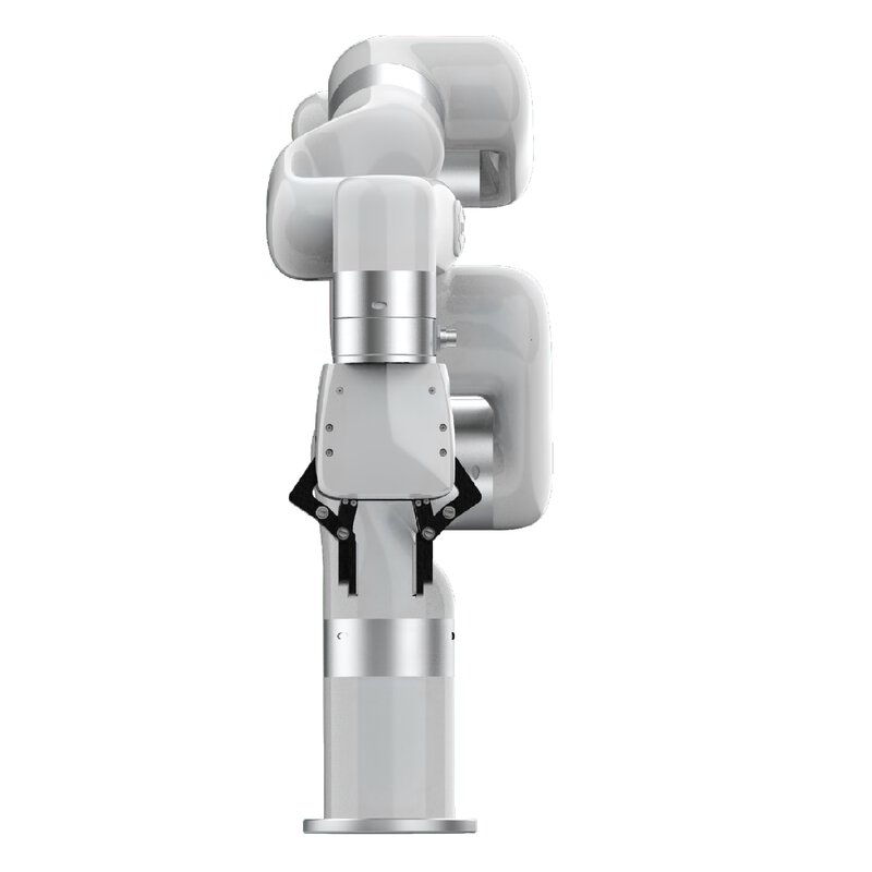

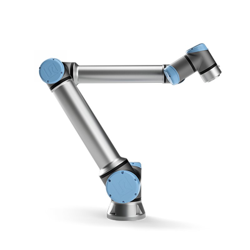

Manipulators
In terms of manipulators that can be installed and integrated with your mobile platform, several recommended arms are available. Each has its own perks and limitations. The table below illustrates some of the key features of the recommended arms that can be installed with the mobile platform.
Comparative Analysis
xARM6
PANDA
UR10E
Company
UFACTORY
FRANKA EMIKA
UNIVERSAL ROBOTS
Host PC
Host PC
Host PC
Teach Pendant
Software Development
Plug & play
Config. Req.
Config. Req.
I/O Ports
Multi
None
Multi
Sensor Integration
Available
None
Available
ROS Control
Immediate
Config. Req.
Config. Req.
Pricing
Low
High
High

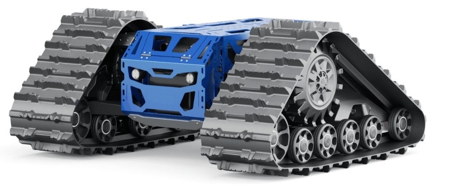

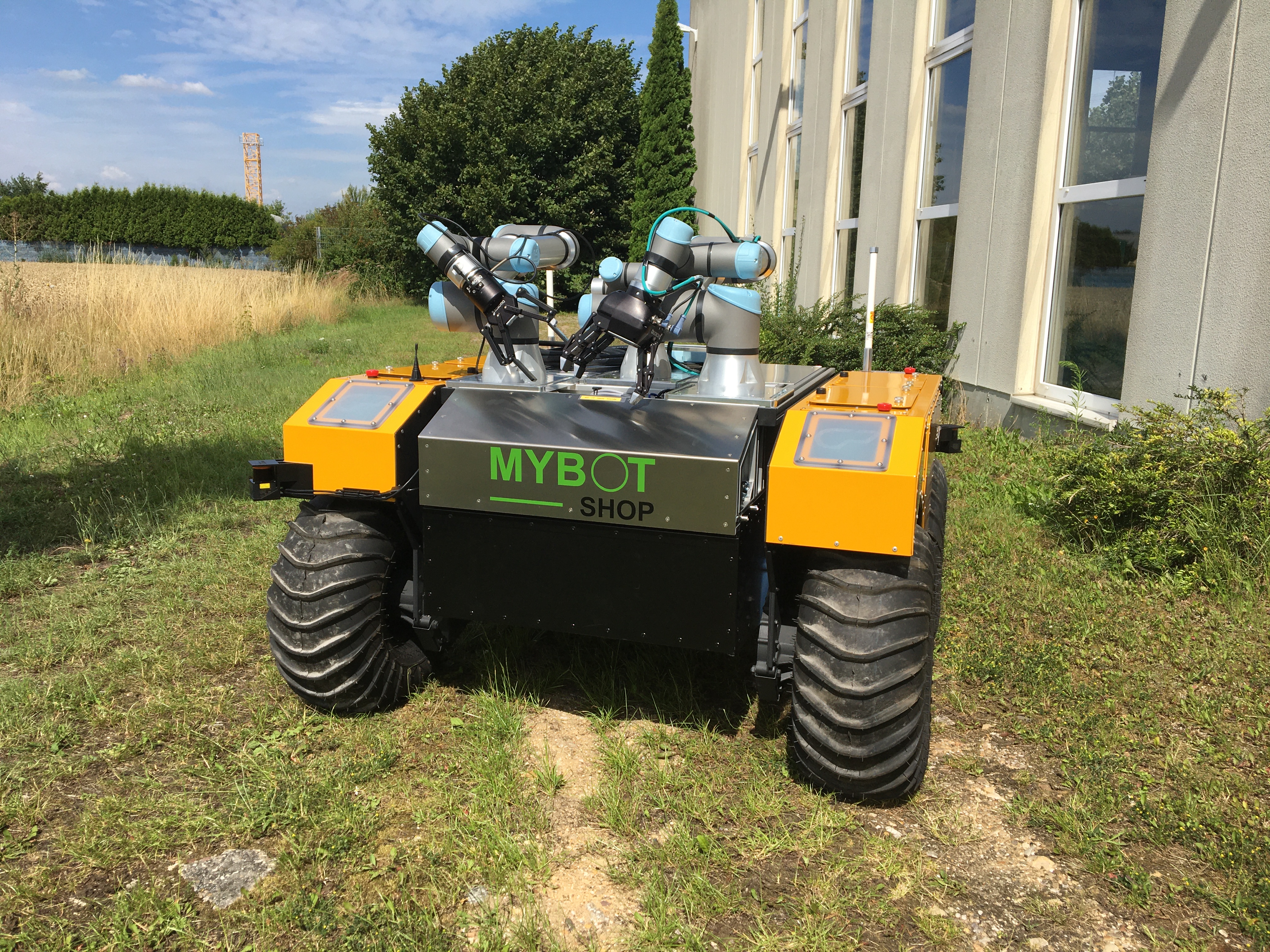

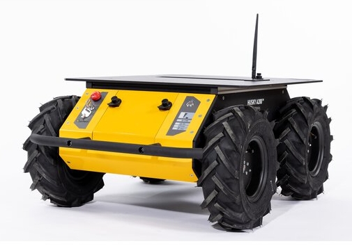

Mobile Platforms
For mobile platform, several recommended mobile platforms are available. A new and interesting mobile platform that can be combined with your robot arm is the ROVO2. The table below illustrates some of the key features of the recommended mobile platforms that can be utilized.
ROVO2
RIDGEBACK
HUSKY
WARTHOG
Robot Weight
290 kg
135 kg
50 kg
280 kg
Payload
500 kg
100 kg
75 kg
272 kg
Operation time
8 hrs
8 hrs
8 hrs
2.5 hrs
Top Speed
20 kmhr
3.96 kmhr
3.6 kmhr
18 kmhr
Terrain Adaptability
Extreme
None
Good
Very good
Pricing
Medium
Medium
Low
High
