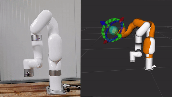

Some quick ways to perform manipulations for the xARM6 are either via the GUI, Studio, or the Moveit Package.
xARM6-ROS
For the xARM6 ROS drivers gui please refer to the Software Packages section. To run the native xARM6 moveit, you may follow the xarm_ros README.md in xARM6 ROS SDK.
xARM6 Moveit
To run Moveit! motion planner to control the real xArm with xArm Gripper attached: First make sure the xArm and the controller box are powered on, then execute:
roslaunch xarm6_gripper_moveit_config realMove_exec.launch robot_ip:=192.168.1.XXX
For planning trajectories via Moveit in python or c++, you may refer to the Moveit Tutorials. These tutorials will provide the basic knowledge to develop and implement your own motion plans.
